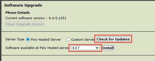

I request you to please check and confirm the software version of the Polycom VVX350 and update it to the latest as mentioned below in the image.

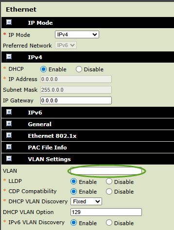

However, for the VLAN, I request you to check the Web UI.
Please go to the Admin Settings.
Menu >> Advanced <enter Admin Password> >> Administrator Settings >> Network Configuration >> Ethernet.
If you are entering the USER password, the options will be limited.
