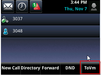

Example 1:
In this example below, we are going to remove the new call softkey, change the function of the forward softkey to forward to the voicemail extension and add a new softkey to dial the voicemail and add our extension and pin automatically.
NOTE: Below has been tested against UCS 3.3.3!
  • Removal of the New Call Soft Key, automate the call forward facility and add automated Voice Mail access softkey
Standard Idle Screen:
Running UCS 3.3.x and using below code:
<feature>
    <feature.enhancedFeatureKeys feature.enhancedFeatureKeys.enabled="1"></feature.enhancedFeatureKeys>
  </feature>
  <softkeyoff>
  <softkey softkey.feature.newcall="0" softkey.feature.forward="0"/>
  </softkeyoff>
  <softkey2>
  <softkey softkey.1.action="$FDivert$$FSelect$$FSoftKey2$" softkey.1.enable="1" softkey.1.label="Forward" softkey.1.use.idle="1" />
  </softkey2>
  <softkey3>
  <softkey softkey.2.action="8500$Tinvite$$Cwaitconnect$$Cpause4$3001$Tdtmf$$Cpause4$0000$Tdtmf$" softkey.2.enable="1" softkey.2.label="VM" softkey.2.use.idle="1" />
  </softkey3>
  <divertcontact>
  <divert divert.1.contact="8500"/>
  </divertcontact>
 Running UCS 4.x.x and using below code:
<WEB feature.enhancedFeatureKeys.enabled="1"
reg.1.fwdContact="8500"
  • The efk/ enhanced feature key feature is activated via feature.enhancedFeatureKeys.enabled="1"
  • The 2 original softkey's are deactivated via softkey.feature.newcall="0" softkey.feature.forward="0"
  • The macro for the call forward is "$FDivert$$FSelect$$FSoftKey2$", this emulates the Button presses via the menu.
    NOTE: The above example matches the tested phone and simply emulates pressing the individual keys.
  • The softkey is then activated via softkey.1.enable="1"
  • The name for the softkey is defined via softkey.1.label="Forward" and it is only displayed when idle via softkey.1.use.idle="1"
  • The macro for the voicemail is "8500$Tinvite$$Cwaitconnect$$Cpause4$3001$Tdtmf$$Cpause4$0000$Tdtmf$" . This dials 8500 and wait until connected, pauses for 4 seconds and sends the extension 3001 via DTMF, pauses for 4 seconds and sends the password 0000 via DTMF
  • The softkey is then activated via softkey.2.enable="1"
  • The name for the softkey is defined via softkey.2.label="VM" and it is only displayed when idle via softkey.2.use.idle="1"
NOTE: This is only an example and numbers may need to be changed to match the local setup. The Admin Guide and the Feature Descriptions & Technical Notifications Page contain additional examples.
The Phone now shows the new softkey's:
Pressing Forward will toggle between call forward on or off

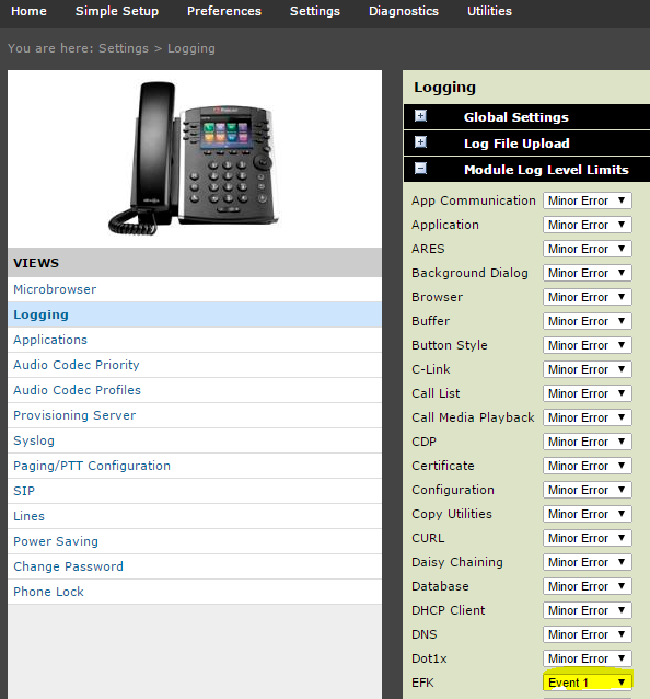

Under certain circumstances it may be desirable to debug an EFK issue if the feature is not working as expected
Lower the logging level for the EFK either via the Web Interface:
Or a configuration file:
<Logging log.level.change.efk="1" />

UC Software 6.0.0 added the ability to create an EFK which a Prompt which gives the user access to the Phone Screen in order to select the Lines or BLF's or Speed Dials.
The above is a directed call pick up EFK which when pressed offers the Prompt and then once selecting the Lines softkey, dials the chosen contact.
Another example could be to Dial a Voice Mail of a specific user
In the above example, the user pressed the ToVM Softkey. This presents him with prompt voice mail. Selecting the Lines key will allow him access to his idle display. Selecting the extension 3048 will then dial 8500 and DTMF 3048
Example config:
<test feature.enhancedFeatureKeys.enabled="1"
	softkey.1.action="8500$Tinvite$$Cwaitconnect$$P1N4$"
	softkey.1.label="ToVm"
	efk.softkey.alignleft="1"
	efk.efkprompt.1.label="Voice Mail"
	efk.efkprompt.1.status="1"
	efk.efkprompt.1.type="numeric"/>
