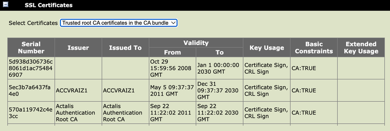

You do mention you import a certificate but you do not state if you selected this to be used rather than the built-in certificates that come with the firmware version. The easiest way to verify this would be via a Wireshark trace so you can "see" what Cert is being used in the communication.
In the past, I created a FAQ for FTPS >here< which shows the error you describe. I did a similar post >here< for HTTPS
Via the Web Interface Settings > Network > TLS > SSL Certificates would list the built-in certificates and their validity.

Our VoIP FAQ contains this FAQ post:
Jan 27, 2015 Question:How can I verify the certificate validity period used with the Poly VVX / CCX / Trio Phone software?
Resolution: Please check this post => here <=
The above no longer links to a valid document as due to the change from Polycom\Poly to no HP this platform has retired.
Using the Web Interface, using a phone that supports this, simply browse to Settings > Network > TLS > SSL Certificates
The above lists all the built-in certificates and their validity etc.
