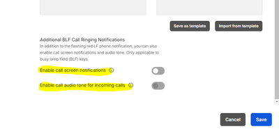

You didn't say if you are using 8x8 for your phone service but. We had a similar issue in 8x8, we had to disable the Enable call screen notifications setting and disable the Enable call audio tone for incoming calls settings.
We had to disable 2 settings in the 8x8 Device settings.
