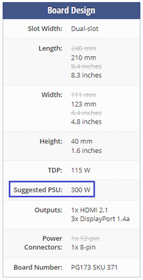

1.) Upgrade your power supply with a 400-watt unit, with part number: L69242-800 (alternatively: 942332-001, L04618-800). You can purchase ($83) this power supply online, such as via this top-rated and trusted eBay Seller: https://www.ebay.com/itm/305134498625?_skw=L69242-800&epid=3038039156&itmmeta=01JE6G96H8Q355D9PR3RK7....
This power supply is the one you need, with its "P2" power connector looking like this:
2.) One of the best low-cost high-performance graphics card models offered these days is the RTX 4060, and specifically the smaller-sized (dual fan) options powered by a single 8-pin PCIe power cable, such as this Amazon purchase ($295) option: Amazon.com: PNY GeForce RTX™ 4060 8GB XLR8 Gaming Verto™ Dual Fan OC Graphics Card DLSS 3 (128-bit, ....
And there you have it: 83 + 295 = $378: right in the middle of your project budget number.

@Andrew_H_Z,
You're welcome -I've been doing this for a while.
1.) Yes, the quality HP 400-watt power supply I referenced is more than sufficient to power the PNY RTX 4060 graphics card:
Link: PNY RTX 4060 VERTO Dual Fan OC Specs | TechPowerUp GPU Database. Mind you, 300-watt is a bit too optimistic in my opinion.
2.) Remember what I mentioned about the "P2" power connector?  This is what the Amazon power supply's "P2" looks like:
My response: I would advise against it.

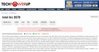

What's your thoughts on the compatibility and reliability of the new Intel Arc B570? I know it was just announced, so no one has actual tried it.

@Andrew_H_Z,
As the old and tried saying goes: a picture says more than a thousand words -sure, post a picture!
How do I feel about the Intel Arc B570? Well, for starters, this particular card hasn't been released yet:
And its published graphics performance compared with the RTX 4060 is lackluster:
Link: https://www.techpowerup.com/gpu-specs/arc-b570.c4245.
But most importantly, Nvidia cards have the best developed graphics software and graphics features compared with any other gaming cards, AMD included -in my opinion.

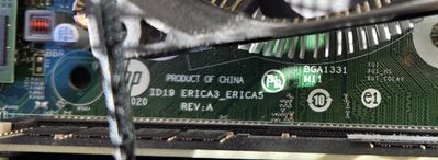

In one place, my motherboard is printed ID19 ERICA3_ERICA5 REV A. This is shown in a photo I posted earlier today.
However, a white sticker on the motherboard states SP#L56021-605 WIN, and in HP Parts Surfer, this is Erica6. Same white sticker also states L56021-005 which is Erica6 again.
The HP specs for Erica3 and Erica5 do not mention my CPU Ryzen 7 5700G, while Erica6 specs do mention this CPU. Therefore, I conclude I have Erica6.
