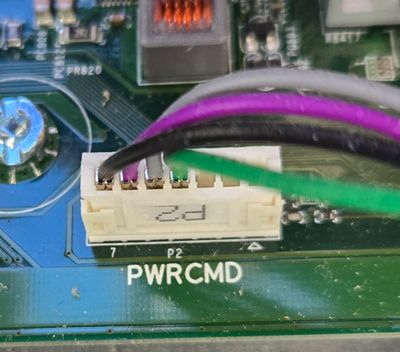

Circling back regarding the 400-watt power supply upgrade: check your existing (stock) power supply's "P2" power connector. If it got three wires, then you should be A-OK with the Amazon 400-watt power supply reference you showed.
Kind Regards,
NonSequitur777
12-03-2024 09:53 PM
The weird thing is my power connector looks not exactly like either connector you mentioned. Mine has four wires: black, purple, grey, green (in that order), so it's more like the three-pin with an extra wire. It does have empty slots for wires. If it helps, I could post a photo of my connector.

As the old and tried saying goes: a picture says more than a thousand words -sure, post a picture!

Come to think of it, looking at Amazon's three-wire "P2" power connector and in particular about the purple wire holistically, I had this experience a while back with one of my upgrade projects:
Meaning, you can try out the Amazon 400-watt power supply, and if for some reason it doesn't work out, you can return it to get your hard-earned money back. Easy-peasy. (Yea, done that, did that!)
