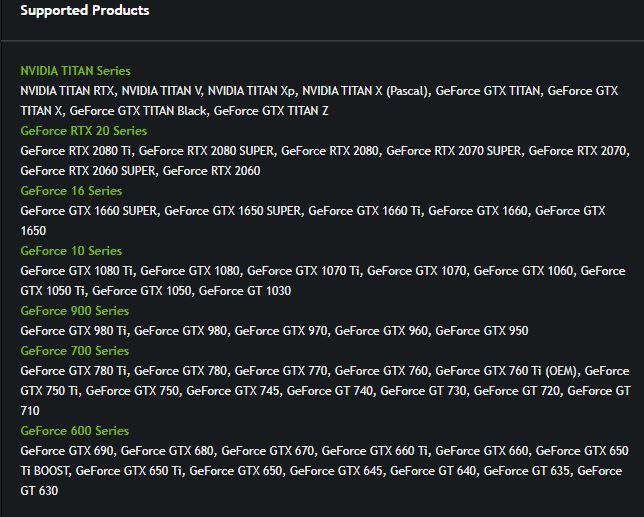

The actual driver for that ID is in the Display.Driver folder>nv_dispi setup information file.
12/06/2019, 26.21.14.4166, which shows that the driver is installed.

This is the specs for the NVIDIA driver Paul  is speaking of, and that I have downloaded.  Look down to the bottom and you will see that this driver IS for the GT640.
Paul,
I purchased a GT640 card from eBay. I've been working with NVIDIA for about a week now with no "real" success. The NVIDIA drivers are installed and supposedly being used, the hardware ID says it is NVIDIA, the driver says it's NVIDIA. Everything points to NVIDIA, yet the Device Manager calls it a Microsoft Basic Display Adapter, the memory the GPU card is supposed to have is 2G, yet, it shows as 0, hardware acceleration is not working and the aspect ratio is wrong (large black boarder).
