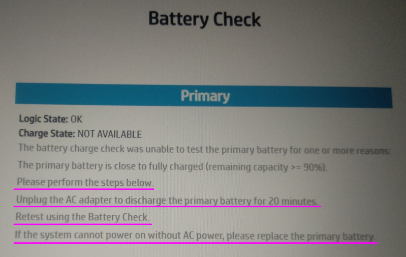

Hi @Ub6424
After performing below 2 steps I have found the few errors. Can you please check and let me know what steps to perform further.
(1) Backup <all> personal data (documents/pictures/videos etc...) to external USB hard drive
(2) Test your hardware Using the HP PC Hardware Diagnostics (UEFI)

2022-08-10 22:56:12 Battery Test Started
2022-08-10 22:56:12 [L]> EfiBatteryLibGetSmartAdapterStatus: AdapterStatus is '1'.
2022-08-10 22:56:12 System reports 1 batteries supported.
2022-08-10 22:56:12 Battery Pack Supplier Index: 1.
2022-08-10 22:56:12 Battery MFG Date 2/24/2022.
2022-08-10 22:56:12 Battery0: Charged to 99% and current is 2233mA. Adaptive Battery Extender is set in BIOS: Enabled/Not Activated
2022-08-10 22:56:12 Will not check battery charging since the remaining capacity is bigger than 90%
2022-08-10 22:56:12 Battery 0: Charge not detected, Executing Battery Full Test
2022-08-10 22:56:12 [L]> Battery state is good.
2022-08-10 22:56:15 Battery 0 returned 0x0000000000000000
2022-08-10 22:56:16 Batt 0: Result: 0x0
2022-08-10 22:56:16 Batt 0: Serial: 23166 02/24/2022
2022-08-10 22:56:16 Batt 0: Manufacturer: 313-17-4B-A
2022-08-10 22:56:16 Batt 0: CTNumber: 6KXCK0EWYGBHVI
2022-08-10 22:56:16 Batt 0: DesignCycleCount: 1000 Design Capacity: 4550mAh Full Charge Capcity 4550mAh
2022-08-10 22:56:16 Batt 0: RemainingCapacity: 4522mAh Max Error: 0000000 CycleCount: 4
2022-08-10 22:56:16 Batt 0: Temperature: 000031 Voltage: 16389mV Current: 2233mA
2022-08-10 22:56:16 Batt 0: DesignVoltate: 15400mV StatusWord: 0x00080 CellVoltage1: 4091mV
2022-08-10 22:56:16 Batt 0: CellVoltage2: 4106mV CellVoltage3: 4101mV CellVoltage4: 4092mV
2022-08-10 22:56:16 Batt 0: Warranty: 000003 Calibration: 0x00001 ChargeControlSupported: YES
2022-08-10 22:56:16 Batt 0: ACPowerOn: ON ChargeTempOK: YES ChargeTest: 0
2022-08-10 22:56:16 Batt 0: ChargeCapacity: 100mAh TempAlarm: NO DeepDischarge: NO
2022-08-10 22:56:16 Batt 0: FullCharge: NO FullChargeStatus: 000000 BatteryCharge: YES
2022-08-10 22:56:16 Batt 0: LowVoltageDisable: NO AdaptiveBatteryExtender: Enabled\Not Activated
2022-08-10 22:56:16 Overall Battery Result = 7

Took Below Snapshots while performing Diagnostics Test:-
Thanks for huge report ...
Do what Diagnostic is telling you, please.
