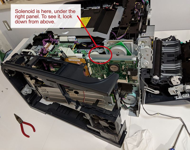

My CP2025dn exhibits the classic symptoms of a "sticky solenoid".  After sitting idle for a l-o-n-g time, it will print one or two pages (either from a print command or any test page).  After that, any attempt to print will result in constant recycling of failed attempts to pick.  I have found numerous descriptions of how to clean the pick solenoid to correct the issue, but I have yet to find anything that tells me how to locate and remove the solenoid on my printer model.  It appears to be pretty straightforward on many HP printers, but not on the CP2020 series.  Can anyone provide guidance on how to access my pickup solenoid?  Thanks.
This guy, East2100, has a brilliant solution of using a piece of paper, without having to remove the solenoid. I just tried it today and it worked! However, you have to remove the right cover, the rear-upper cover, the upper-cover, the control panel, and finally the right panel, just to see it. I'm no repairman, I just followed the instructions in the HP2020 Service Manual. Go to Page 136, Right Panel, and it will tell you what other pages to go for step-to-step instructions of all of the above parts.
Here's one of East2100's posts about this problem: Where to find the sticky solenoid
And here are my photos that might help someone like me who is not a professional.
First, prepare the paper:

@RPHK - Many thanks for your solution.  Your photos and description were spot-on.  I couldn't follow East2100's description.
Glad to help, but I'm just an amateur. East2100 is a professional, and the paper is his brilliant solution. I just found some photos of his in this thread, for a different model of printer, but shows the solenoid clearly and the paper placement clearly, as the solenoid was removed:

No, Valsimot, this is not the paper pickup solenoid. However, East2100's solution did solve my problem, which is just as described by the original poster.
If my printer has one sticky solenoid, the others are probably also sticky, right? I would appreciate it, if you could tell us how to access those on the CP2025.
Many thanks in advance!
I second the comment from @RPHK:  I've searched everywhere  for the locations of the other solenoids on the CP2020 / M451 series, but no success.  It would be really helpful if someone could provide that information.
