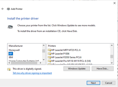

Hi Asmita
I can get most of the way down these instructions, but when I select HP as the printer, the HP Laserjet P1102W driver does not seem to exist?  It does not appear to be called an 'HP Laserjet Pro P1102W' either (although it sometimes appears to be elsewhere on the web).
Any ideas?  Should I be looking for something else?
Thanks.  Capic

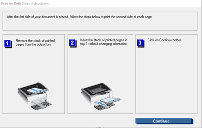

Thanks for this - connecting via a USB allows it to print double sided correctly.  Interestingly, the dialogue box asking you to 'reinsert the pages in the feeder tray' is also the one that used to appear when using wireless through Windows 7 (and is shown below).  The 'wireless through Windows 10' dialogue is different:
Dialogue box for Windows 7 wireless / USB connection:... which prints okay
Dialogue box for Windows 10 wireless connection:... which prints the second side in reverse order and upside down
