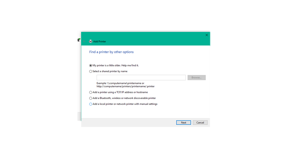

Perhaps, I made wrong choices in the add printer dialolg to set up Ethernet. I have attached a screen shot of the add printer dialog. Would you mind walking my through the availble options within the options.

06-08-2016 03:25 PM
Use the option add printer using tcp/ip address or hostname. After you click on next it will ask for the ip address which you should enter and then click on next. It should find the printer and go to the maker's page and you just select have disk and then browse to the folder where unzipped the files and select and complete and it should work.
