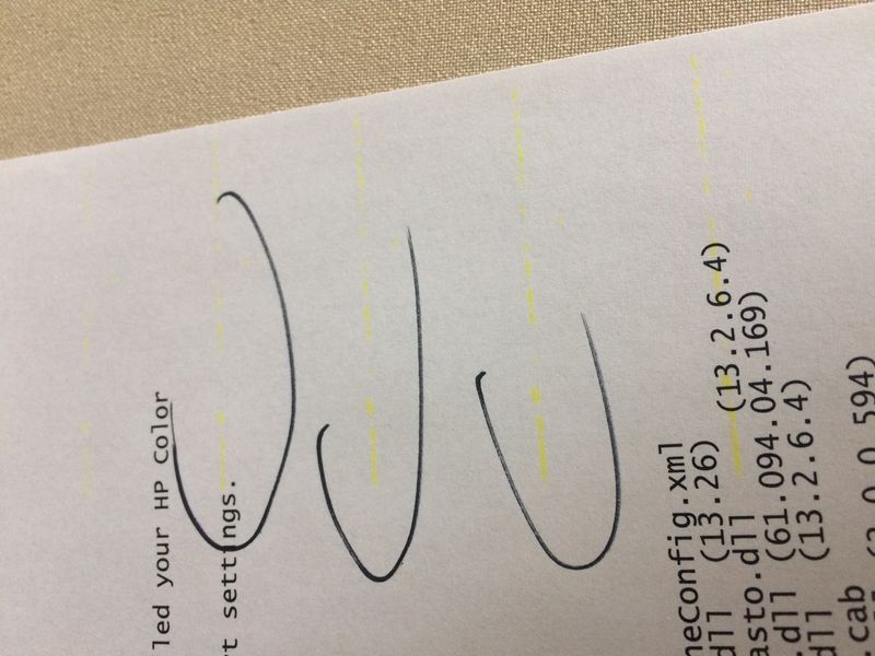

I have a similar problem, although not necessarily (not at all) associated with heat. From new, this M452nw has been making horizontal parallel yellow dashed lines exactly 7/8in apart (they resemble Morse code) in the right one third of each page, top to bottom. That happens only when I print color (i.e. not when "B/W only is selected). In addition to that, there is a faint black short dash on the left third of the page, also repeated with the same distance.
I tried the cleaning run and also changing the default paper weight, to no avail.
Any ideas? Thanks. Z

Here is a picture. The yellow lines are marked by a pen.
As soon as this picture is released by a moderator for viewing i will give a feedback what i think the problem might be.Hope this will help.

I viewed the picture and would like to know the distance from one line to the next line.This way we can determine from what roller the problem arises.I look out for your reply.

The distance of the lines is very close to 7/8 of an inch.
Z
According to the spacing it seems like the developer roller is giving a problem
22.3 mm ( 0.87 in) Developer roller (one rotation) Appears in a single color plane
