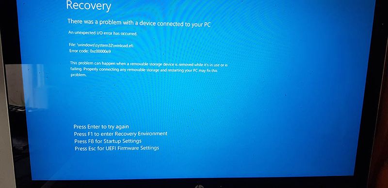

Hi! I have a problem booting my laptop. It shows "Automatically repair" and then a blue screen "An unexpected I/O error has occurred - Error code: 0xc00000e9". When I try to boot with USB, it shows "The selected boot device failed. Press ENTER to continue". I tried to upgrade to a SSD unit but it's the same. These are things that I did without success:
- I enabled "Legacy Support" on BIOS.
- I changed the priority in "Boot" option on BIOS.
- I disabled "Secure boot" on BIOS.
- Tested with "Hardware Diagnostics" (F2) (success)
- Tested with different RAM.
- Tested without battery.
But it's weird because, if I shut down it for two days and try to turn on could boot OK. I guess could be a electrical or short problem with the motherboard. Anyone in the same condition.
Regards!

02-12-2021 09:04 AM
Thanks for you reply! Could not make sense for you but it's hard to explain. Now, the laptop is in UEFI Mode and goes into "Automatically repair" or "please wait" and then:
(blue screen)
"Recovery
There was a problem with a device connected to your PC
An unexpected I/O error has occurred.
File: \windows\system32\winload.efi
This problem can happen when a removable storage device is removed while it's in use or is falling. Properly connecting any removable storage and restarting your PC may fix this problem."
Regards!
02-12-2021 10:41 AM
This is what happens when you switch modes -- file systems get corrupted.
Microsoft is trying to recover the corrupted file system, but that failed, so it's trying over and over again -- and will never succeed.
This problem is very difficult, if not impossible to fix -- from the standpoint of making repairs and leaving your stuff intact. Some steps for trying this are listed below, but they are very hard to do and if they do not work, you are faced with doing a complete Windows reinstallation to get your PC back working again.
First thing you need to do is see if you can restart in Safe mode -- by doing these steps: https://www.tenforums.com/tutorials/2304-boot-into-safe-mode-windows-10-a.html
If you don't know how to start using Advanced Startup Options, then read this: https://www.tenforums.com/tutorials/2294-boot-advanced-startup-options-windows-10-a.html
Then, follow these steps to reset Windows Update: https://www.tenforums.com/tutorials/24742-reset-windows-update-windows-10-a.html
If these work, when you finally reboot, you should then be able to login to a working Windows desktop.
If these don't work, then report that back here as we will then have to provide you information on reinstalling Windows.
