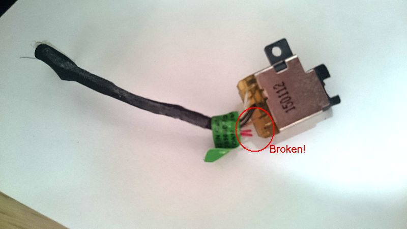

I found out what the problem was on mine.  It was the power connector.  The connector broke inside the laptop. The power connector is poorly designed.  It's only held by 1 screw on one side to hold it.  As such, when you insert and remove the power plug, it acts like a hinge like when you open and close a door.  The whole unit moves in the process until the tiny wires connected to it breaks.
Here's the part you'll need.  P/N: 801513-001
You can get one from eBay.
It's so sad to see a $1,300 laptop inoperable because of poor design.  How much does it cost HP to fix these under warranty?  How much is the cost to the consumers if out of warranty?  Goodwill cost?  HP's reputation for having poor quality laptops?  A LOT!  It could have been designed much better without additional cost.
