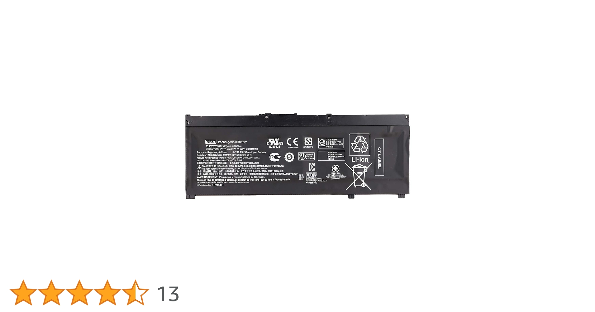

How old is the battery? The laptop is at least 3 years and that is about the expected life of a battery.
(19) Battery (4 cell, 70 Wh, 4.55 Ah) 917724-855

Thanks for your reply Huffer. The battery is from September 2017, same as the laptop, 3 years old. I expect it to be expired indeed.
If I understand it correctly I need a battery product number: 917724-855
Also it is unclear to me whether I can replace this battery myself. I have no doubt about my technical abilities, but the laptop is fully closed at the bottom. Is this a case of removing the lid, replacing the battery and closing it up again?
