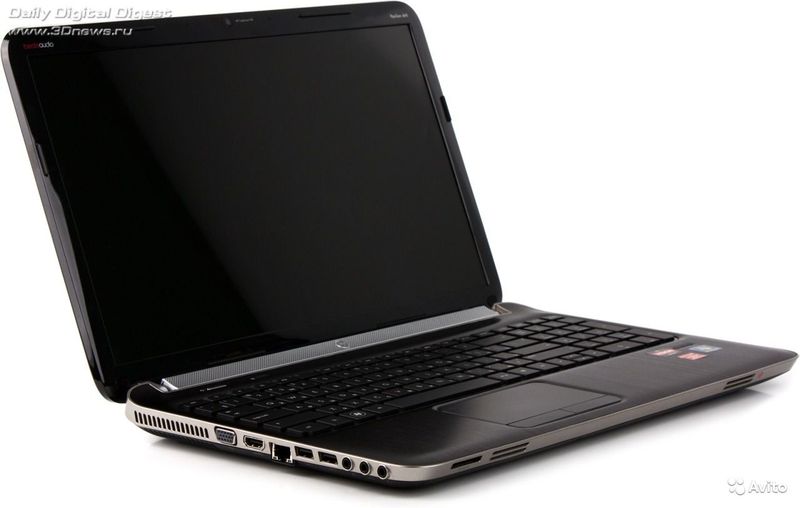

04-03-2018 10:28 PM
But if I remove the battery, it says it is running on AC power. The battery still charges but when the AC adapter is removed it instantly turns off. The battery still produces heat so it should be a setting that I accidently turned off.
(This is the model that I have)
This is the model I have.
04-04-2018 09:40 AM
Models look very similar so the picture is interesting but not really helping. Model number should be on a tag inside the battery bay. Nothing you are telling me is persuading me it is anything other than a battery that needs to be replaced.
