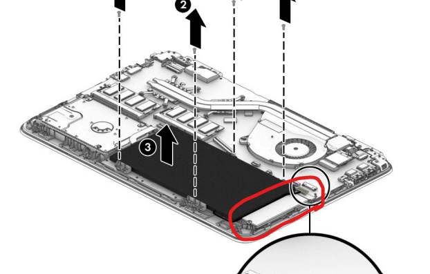

@Paul_Tikkanen,
The illustration below of page 36 shows both a hard drive and M.2 SSD, which gave me an impression that this model supports both HDD and M.2 SSD. Thank you for straightening it out.
@Aedy,
Hopefully, you haven't got or ordered an M.2 SSD yet. Please follow Paul's advice. Sorry for confusing you.
