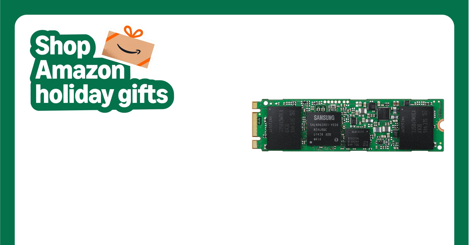

Many thanks for your reply
But, the m2.sata mentioned by rmhutchins in his link http://www.amazon.com/gp/product/B00TGIVZTW?psc=1&redirect=true&ref_=oh_aui_detailpage_o00_s00, has three dips and you mention that yours has two dips
is yours the same as rmhutchins which has three dips or another one
Please help

is yours
Samsung 850 EVO 500 GB M.2 3.5-Inch SSD (MZ-N5E500BW)
in this link
or
Samsung 850 EVO 500 GB mSATA 2-Inch SSD (MZ-M5E500BW)
in this link
from your pictures it is the first one which has three dips
