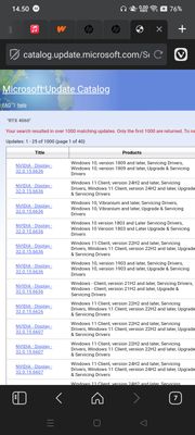

@Banlix,
Yes?  -Pick the most recent.
Kind Regards,
NonSequitur777
What am I supposed to do with that once I download it?
Extract the .cab file into a folder, then open the device manager.
In the device manager, click the "Add drivers" icon and navigate to the folder where you extracted the .cab file.
