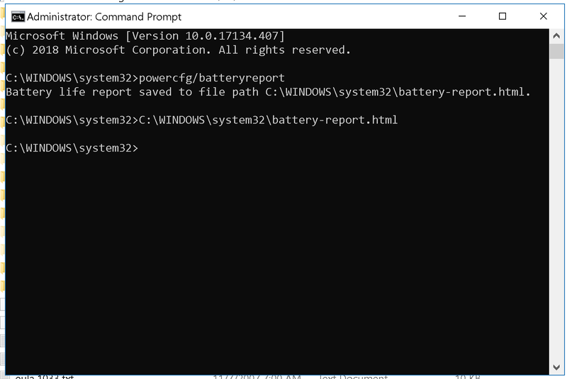

Boot into Windows and a command line window (with admin priveleges).  See the image below and replicate the commands.
When you enter the c:\Windows\system32\battery-report.html  command and press enter, your default browser will display the battery report that Windows has generated.
Kindly post the result as seen at the bottom of the report here in your thread.
