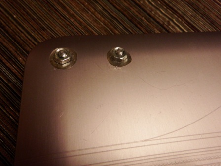

Hello girikannat, RandomHuman, HP sauce12, teakadi, AbhijitD and 100 others... HP will not help you. Omar-E, Jeff, kevin-t all work for HP and will offer you a token bowl of rice or a print cartridge for you to go away... you are on your own. HOWEVER, I will explain the issue again and explain a fix IF you are up to the challenge. The hinge is NOT the issue. The hinge attaches to a black PLASTIC frame that is glued to the aluminum top on the inside. The plastic inner frame disintegrates and breaks apart. It is NOT the hinge but the plastic attachment point inside ithat breaks apart and destroys the display. If you wish to fix this hinge on your own you must remove the hard drive, memory, dvd drive, bottom cover, keyboard, top cover, display cover to finally reveal the hinge area. You must drill holes through the aluminum top and secure the hinge directly to the aluminum top cover with small screws and nuts - see my picture. In addition, I used epoxy resin over the nuts to hold them securely.  HP has the entire removal procedure on their website. But, they do not show how to drill through the top to secure the hinge directly. It took me 8 hours to complete this procedure. I wish there was a faster fix, but this is why HP will NOT HELP YOU... It's a time-consuming and very costly repair. Hinge Close Up Web.jpg

I finally got to fixing the hinge on my wife's computer. My experience was somewhat different from some other users.
The fix was very similar to that of user hmmmmm (# of m's not exact) and others with some variation. The simple fix is that you need to affix the hinge to the exterior case of the laptop (and count ourselves lucky it's metal and not plastic!). Replacing the internal plastic frame would be rather more complex and only last a short period of time.
I removed the bezel and drilled holes in the cover, inserted screws. reinforced with washers and secured with nuts.
- #4-40 screws worked well (bought from Lowe's in the U.S.), 3/8 inch length screws worked very well and almost doesn't require sawing (just one screw of 3). Recommend 3 screws per hinge for best chance at stability/support.
- bezel pops off with guitar pick or similar device and snaps back into place. Patiently work your way around.
- interior plastic frame was fairly intact in my case except for where the hinge screws pulled through (what an absolute "lemon" of a design...).
- hinge metal was hard for my drill bits (had to widen the holes to accommodate those #4 screws) but Dremel tool worked quite well (low to medium RPMs or you can melt the bit like I did...)
- didn't have to break off the hinge cover (1 remained) as the bezel came out from behind it
- I used pan head screws so the reassembled laptop would not quite close properly until I drilled holes in the bezel to allow space for the screw head. It shows but it's not severe at all.
- seems #4 lock washers have to be ordered so epoxy is interesting as a fixer but takes time to harden
- total time about 1:30-45 includes trip to Lowe's after melting the Dremel bit.
Disappointed in HP's design here as you'd figure an engineer would know that thin plastic frame would not hold up in this application. This rather nice laptop has a sweet aluminum shell, why wouldn't you just add protruding screw holes in the mold for the lid? (Anyone from HP want to pick this one up?)
At least it can be fixed, though! Thanks to the examples provided by hmmmm. Good luck everyone!
