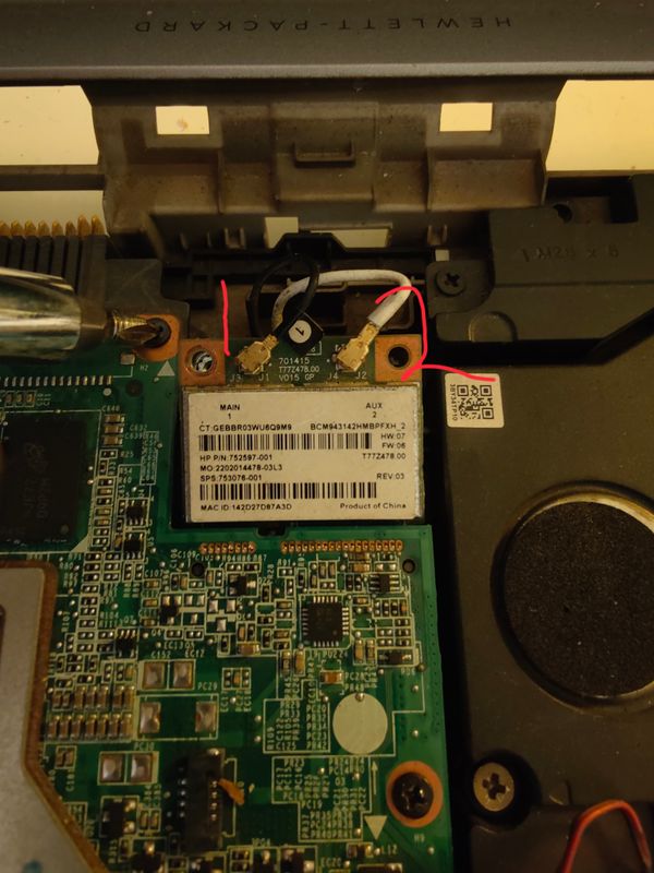

Hello,
I've had my trusty HP Envy 15t for about 10 years now and it's never let me down. Lately, however, I've become quite dissatisfied with its performance. Obviously, it is an old laptop (4th gen i7-4510u processor) so I can't expect too much from it, but I do not currently have the funds for a new laptop, either.
I've been wanting to upgrade the storage to a SSD drive. I have disassembled the motherboard and seen that there seems to be an empty M.2 port on the backside of the motherboard. My question is, could I stick a 1TB Teamgroup MP-33 stick in there and call it a day, or would that storage be incompatible? I'm having trouble finding out how much memory the motherboard would support, and which kind of memory I should be looking for.
I would also like to upgrade the wifi/bluetooth combo adapter which is very sluggish, receives only 2.4Ghz signals, and is unreliable at best. My laptop came with the Broadband BCM43142 bgn adapter which is connected via 2 antennas (one says main, the other says aux). I've been looking up this adapter everywhere and I can't seem to figure out if it is 1x1 or 2x2. I was wanting to replace it with the latest MPE-AX300H wireless wifi/bluetooth combo adapter, however I can't figure out if it would be supported by my motherboard. My BIOS is Insyde F.43, if it helps.
Photos are attached, hoping that they might be of help. Please help me breathe new life into this laptop. Thank you!
Hi, @hakjaved
The Wi-Fi card your notebook currently has installed is 1 x 1 but that has nothing whatsoever to do with the type or number of antenna wires.
1 x 1 and 2 x 2 are the number of data streams up or down that the Wi-Fi card can support.
2 x 2 means double the throughput.
For example, the maximum throughput of your notebook's BCM card is 72 MBPS.
If the card were 2 x 2, the throughput would have been 144 MBPS.
I bought that same Wi-Fi 6E card for my HP 350 G1 notebook which has an Intel i3-4005U processor.
Works great.
I can't 100% guarantee it, but it should work in your notebook too.

I believe that all three of the above links pertain to the laptop I am attempting to upgrade. However, I have still not been able to find a solution to my WiFi/BT combo adapter problem. Is my current adapter 1x1 or 2x2? There are two antennas present, however I cannot be sure... I would like to know if the MPE-AX3000H 2x2 would be compatible with my system.

Hi, @hakjaved
Works great.

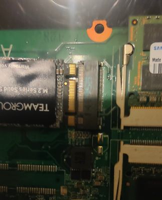

@Paul_Tikkanen
Houston, we have a problem.
While the WLAN adapter install went flawlessly (went from 8Mbps to 400Mbps+ download speeds overnight), unfortunately the same can't be said for the SSD.
I've tried everything I could and just can't get Windows to recognize the SSD after inserting it into the port. I'm at my wit's end and am hoping that I haven't purchased the wrong SSD, even after all the research put into this decision.
According to the following link, it seems like the SSD should work with the port, in theory:
https://h30434.www3.hp.com/t5/Notebook-Hardware-and-Upgrade-Questions/Unknown-port-on-the-back-of-my...
And here is the link to the SSD I purchased off of Amazon:
TEAMGROUP MS30 1TB with SLC Cache 3D NAND TLC M.2 2280 SATA III 6Gb/s Internal Solid State Drive SSD...
As you can see, I was careful not to select a NVMe SSD, and yet it still isn't being detected by Windows. I checked device manager, disk manager, HWiNFO and no dice anywhere. I'm attaching photos of the setup for hopefully more clarity.
On a side note, how ridiculous is it that they can't give a single screw along with the SSD when you purchase one. I had to use one of the screws that came with the WLAN adapter, thankfully had those lying around. It seems to hold the SSD in place pretty nicely, so I'm doubtful that that would be the issue...
In any case, this is frustrating. I'm truly hoping that perhaps there's something I overlooked. It goes without saying that I would truly appreciate your expert opinion with regards to my current predicament.
Thank you.
Hi:
Sorry that the M.2 SATA SSD isn't working.
Unfortunately, I don't know what the problem could be.
It would be unusual not to be able to install a larger capacity SSD.
Have you tried installing Windows on the SSD?
If not, see if that works.
If Windows can't find the drive during the installation, I suggest you return the drive and use a 2.5" SATA SSD instead.
