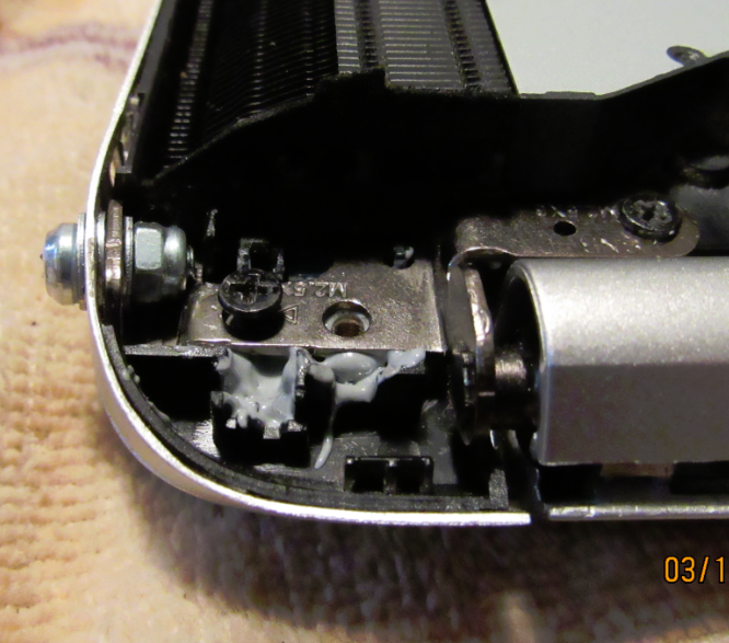

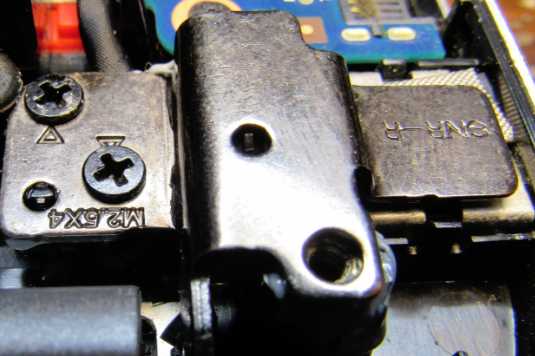

I completed a temporary fix, hopefully this will help others who are experiencing the same thing. I need my computer every day and could not wait weeks to get up and running again. I am not sure how long it will last but it will buy me some time to make a proper educated decision on how to proceed. The left hinge can be secured using a M3 x 6mm machine thread screw, 3 to 4 washers depending on how you position them, and a nyloc nut. On both sides I put the knurled brass threaded inserts back in the fractured / missing plastic holders and epoxied them back into place. I found this fix on another thread of a user repairing their broken Envy hinges. I then loosened the tension on the hinges by backing off the nyloc nut, you can get to the hinges by opening their covers carefully prying each half apart. I then lubricated them with Kroil, you could use any lube as long as you can make sure that you do not get it everywhere, less is more as you want it only on the hinge, not the electronics.
Here are some pictures to illustrate the repair:
Bottom cover, plastic broken so the screw has nothing to catch on and hold the pieces togetherBottom cover, plastic broken so the screw has nothing to catch on and hold the pieces together
Left Side: with the screw / washers / nyloc nut / epoxyLeft Side: with the screw / washers / nyloc nut / epoxy
Right Side: All knurled brass inserts ripped out, plastic is mostly missing that used to hold themRight Side: All knurled brass inserts ripped out, plastic is mostly missing that used to hold them
Right Side: After epoxy repair performedRight Side: After epoxy repair performed
Hinge: Loosen the nyloc nut to relieve pre-tension so the fix does not break as quickly (or hopefully ever)Hinge: Loosen the nyloc nut to relieve pre-tension so the fix does not break as quickly (or hopefully ever)
