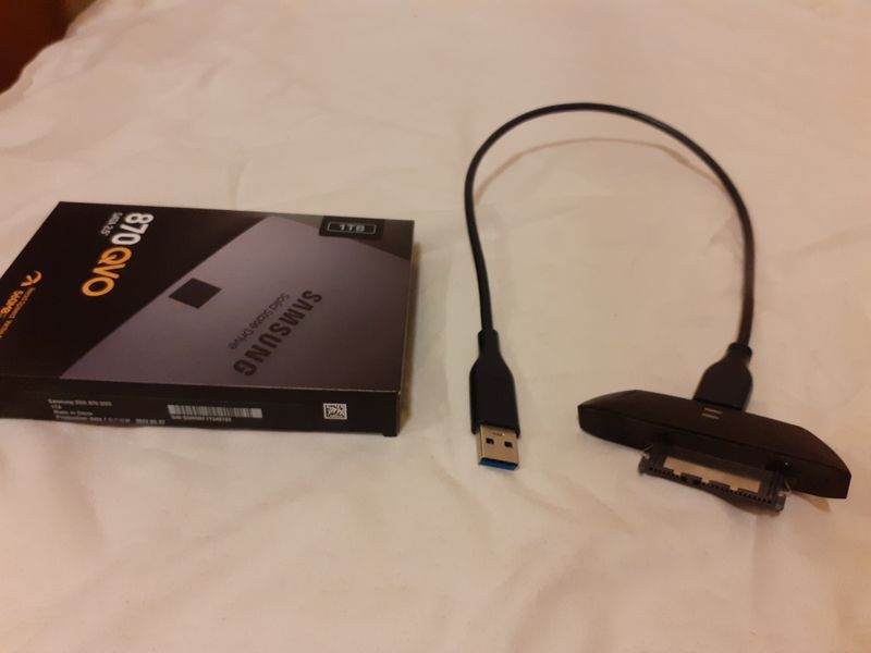

The SSD is new, I have not used it before. After reading your article, I plugged the SSD using a USB cable in the picture and tried the DiskPart utility, still it is not recognized. You can see the device I use to connect the SSD to my laptop.
That is SATA to USB 3.0 cable that I use with my Seagate FreeAgent GoFlex Pro HDDThat is SATA to USB 3.0 cable that I use with my Seagate FreeAgent GoFlex Pro HDD
