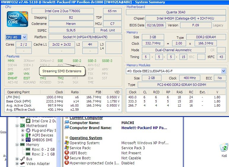

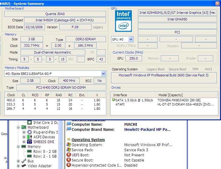

Now I made a screen using HWinfo, with 2x 2 GB of RAM (it is the Dual-Channel Interleaved, 2+1 GB - it was Dual-Channel Asymmetric). Is it possible that the RAM only runs at a frequency of 332.7 (333 ) MHz? I see that there is bios F.09, it is apparently very old, but you wrote that there is probably no newer one, right?
I am sending images with screenshots from HWinfo to see if something could be improved even further.

When you look at any memory report and the memory is in dual channel mode, you have to multiply the reported speed by two.
The report indicates the memory is running in dual channel mode so, 333.5 MHz x 2 + 667 MHz (the dual channel speed).

I don't understand it now. In that screen from HW info, you can see 332,7 = 2x 166.3 MHz

Yes, I don't get that either.
Your notebook's memory is running at 667 MHz in ducal channel mode, so I don't know what the = 2 x 166.7 means.
Mine says the same thing on DDR4-2400 MHz which is running in dual channel mode--1197 = 12 x 99.7.
I wouldn't worry about it.  Take the 333.5 number and multiply it by two - 667 MHz.
