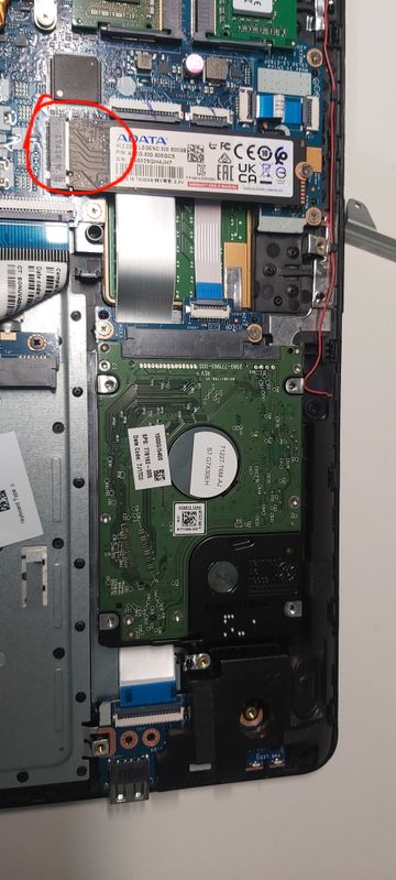

Thanks for your response. I can see that WD SSD has two slots, and mine has only one. See the picture attached for reference.

You're very welcome.
The drive will fit in the slot with no problem.
The one notch fits where the M.2 SSD slot key is, and the other notch just doesn't make contact with any of the pins on the other side of the M.2 slot.
The fact that the M.2 SSD slot doesn't have a key on the other side does not prevent the 2-notch SATA SSD from fitting.
