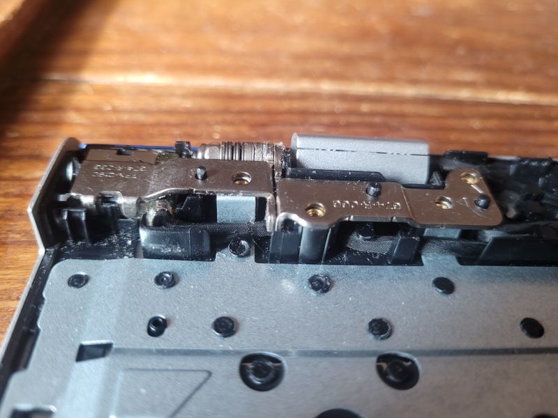

This is a close up of the AC input.
I was told that the metal top in this photo lifts up so I can replace the ac input cable but I don't
see how to do  it.  I don't want to force it and break something.
I was able to find the correct cable on ebay.
Any tips on how to do it.
This is a closeuo photo of the ac cable cover
ac input cableac input cable

This is the solution to the problem:
I showed the computer to 3 different repair shops.
They all wanted to check things that were not broken for prices between 50 and  $150
One shop "fixed it" for 25 by just removing the the ac input wire and replacing it with a new one that I already ordered.
The original problem was that the AC input plug was not going all the way in and so it could not charge.
I called that shop back and then finally -------  The truth.  They told me the problem was a bent pin in the plug.
Funny how nobody told me to check that before.  Nothing had to be done inside the computer.
I had a spare AC adapter that I got from HP previously for another problem  and all was solved.
