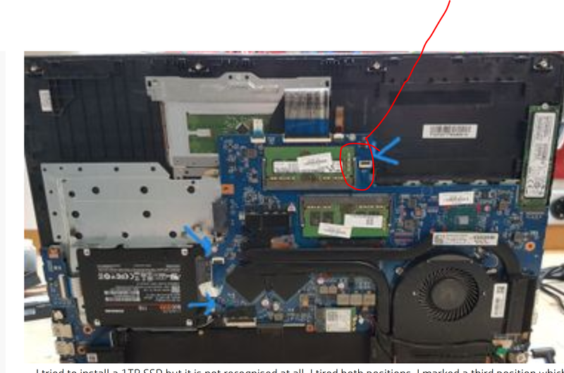

 I tried to install a 1TB SSD but it is not recognised at all. I tired both positions. I marked a third position which sadly isn't soldered on.
Is it possible to add a second drive and if so how?

This is where it should go:
Is the 2.5" SSD new? Once installed did you go into Disk management to initialize the drive?
What cable are you using? Original HP cable for that model?
Do you have a regular HDD lying around you can try, just to see if it starts spinning once you turn on the PC.

I checked the disk management and it doesn't show up. I connected the ssd to a different computer and initialized it to gpt. I might be able to remove a hdd from another computer.
I installed it in the correct postion. It still doesn't show up.
Can you send me a link to the proper adapter?
I tested it with a regular hdd (640GB) it still doesn't recognise it but it makes normal hdd noises. (It spinns)
