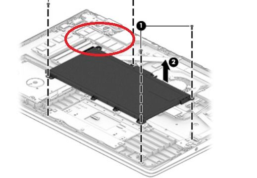

It can take either SATA or PCIe/NVME M.2 disks. Having said that, the Evo 960 NVME has been the source of some reported troubles when users try to install it in HP laptops. Mixed reports of success/no success. I encourage you to try to find the Samsung SM951, PM961 or SM961 since that is what the HP recommended disks are.
See pages 31-39 of the Manual. This is what you see when you remove the back cover and shows where you will find the M.2 slot:
M.2 circledM.2 circled
HP has assured it is OK to open the back for memory or storage upgrade as long as you do not harm and HP obviously will not cover the parts you add.

The Manual is here:
Manual
