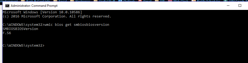

Below is an image (which I think) displays the BIOS version. Another thing to note, this computer is almost two years old. I ran a system diagnostic last week and everything checked out.

F.66 is available. You have F.56.
http://ftp.hp.com/pub/softpaq/sp73001-73500/sp73289.exe
I seriously doubt this will affect the keyboard but HP is strongly suggesting you install the F.66 BIOS so I would also recommend you do it.
