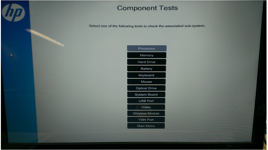

Plug in the power adapter. Log into Windows and open the HP Support Assistant and run the battery test. Post your results here.
If you have the newer UEFI (v 5.1 or greater) environment installed --> press the power button --> tap the Esc key to invoke the startup menu --choose F2  the System Diagnostics  --> HP PC Hardware Diagnostics UEFI --> choose component tests --> Battery Test.
Post your results here in your thread.

battery test results -
Thanks for posting the results. Your battery should last more than one year.

I can't see the image yet.
