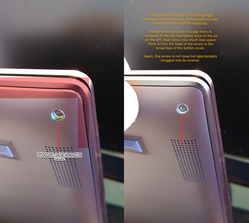

I'm having a similar or the same issue as you @Toby. I have a hp spectre x360 2017 model.
My notebook has never been dropped and handled carefully.  I always put it away in the leather sleeve it came with when I'm done using it and then into a laptop bag.
I first noticed one corner of the bottom panel coming loose and a small gap it created. I wondered if the screw had come loose.
With an appropiate sized screw driver I tested if the screw was loose and discovered it was not. Upon closer inspection I discovered that the screw was no longer holding the bottom cover because the plastic/composite portion of the cover the screw was holding had becomed detached from the rest of the cover.
So imagine a small ring of plasict/composite material still being held by the screw head  yet separated and disconnected from rest of the bottom cover piece.  Now the hole in the cover is larger than the screw head so there it's not physically possible to hold the cover snugly in place with an appropiate fit.
The notebook still functioned fine but I was worried to get this fixed as I would have to ship the notebook away and be without it. Still it was disappointing to find out this cover was made of plastic/composite and not metal like the rest of the notebook body. I understand why hp might make the bottom out of a plastic/composite material and it would not have minded so much had this defect not cropped up.
A little while later I noticed the same thing in the other corner of the bottom cover by the other bottom screw.  That the cover had pulled away from the screw.  The portion of the cover that the screw was hodling was no longer connected or broke away from the rest of the cover and the hole in the cover in now larger than the screw head.
The two bottom screws I'm speaking of are the only two visible screws on the bottowm of the unit and are toward the end of the notebook that would be underneath the track pad but towards the corners.
My concern is having this sent in for repair and them putting another defective bottom panel and the corners coming loose again.
I tried a support chat session but that person was unable to confirm if the part has been updated.  I see this as a less than desirable/deffective design and it would urk me quite a bit to send the notebook in and be without it and then have the same issue happen again.
If anyone else (including HP personel) can confirm that they have improved the design of this part to where this will not happen again with normal use I would very much appreciate it.  Then I could plan to be without the notebook and it would be worth to send in for repair.
It's unfortunate this has happened. I'm sure the plastic/composite material saved some cost, but I have one friend who specifically decided not to get this notebook based on my loose cover/corners experience.
