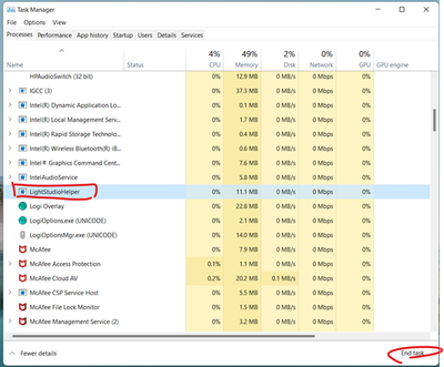

Hi, Please follow these steps, and let us know if it could be fixed or not:
  • Close Omen Gaming Hub and Light Studio
  • Open Task Manager, and kill (End Task) LightStudioHelper
  • Launch Omen Gaming Hub and Light Studio again
It seems that this has worked, though, is the light studio something I’m supposed to keep open or can I close out of it now that the animated lights work again ?
