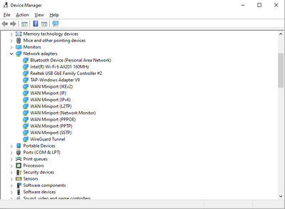

And here are all the "Network adapters" installed. I suspect my internet connection is flowing through the "Realtek USB GbE Family Controller #2". Certainly that is what Task Manager displays.

As best as I can tell, I think I have solved this problem on my own. It always seemed suspicious to me that (as I wrote in my 3/7 message) the network adapter driver "Realtek UB GbE Family Controller" was five years old. The driver remained old even though I ran Windows Update repeatedly, and I clicked "Update driver" for that driver within Device manager. Out of curiosity I went to the Realtek site and downloaded the driver manually. The updated driver is dated 10/29/2020, Version 10.43.20.1029...and the problem has not reoccurred for over a week.
