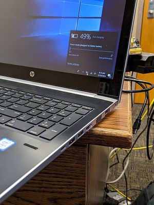

I have an HP probook G5 that keeps giving power related errors. As you can see in the picture, the laptop is not connected to anything except battery however it says plugged in not charging. The only resolution we have had is letting the battery completely die then plugging it in long enough we can assume the battery has totally recharged and powering it back on. I have tried removing the battery related drivers and rebooting but the battery on this model is not readily accessible. In its current state it will not charge and logically cannot tell if it is plugged in or not. Same results regardless if it is charged through thunderbolt3 doc or the oem ac adapter and have swapped both the dock and adapter for troubleshooting.
not plugged in but displays device is not on battery power

There are 376 models in this popular series, introduced anywhere from 2017 to 2019 depending on region (location on the planet).
If your system is still under warranty, it is worth contacting HP Technical Support. Open a case, ask the question.
If your system is in the "older" introduction range, it is worth completing the component tests on battery and AC charger to see if the tests can help determine what is going on.
Regardless of the test results,
If the battery is in the "older" introduction group, that is, the battery is two years old,
and the battery is misbehaving to the extent you describe,
it is worth considering replacement of the battery.
