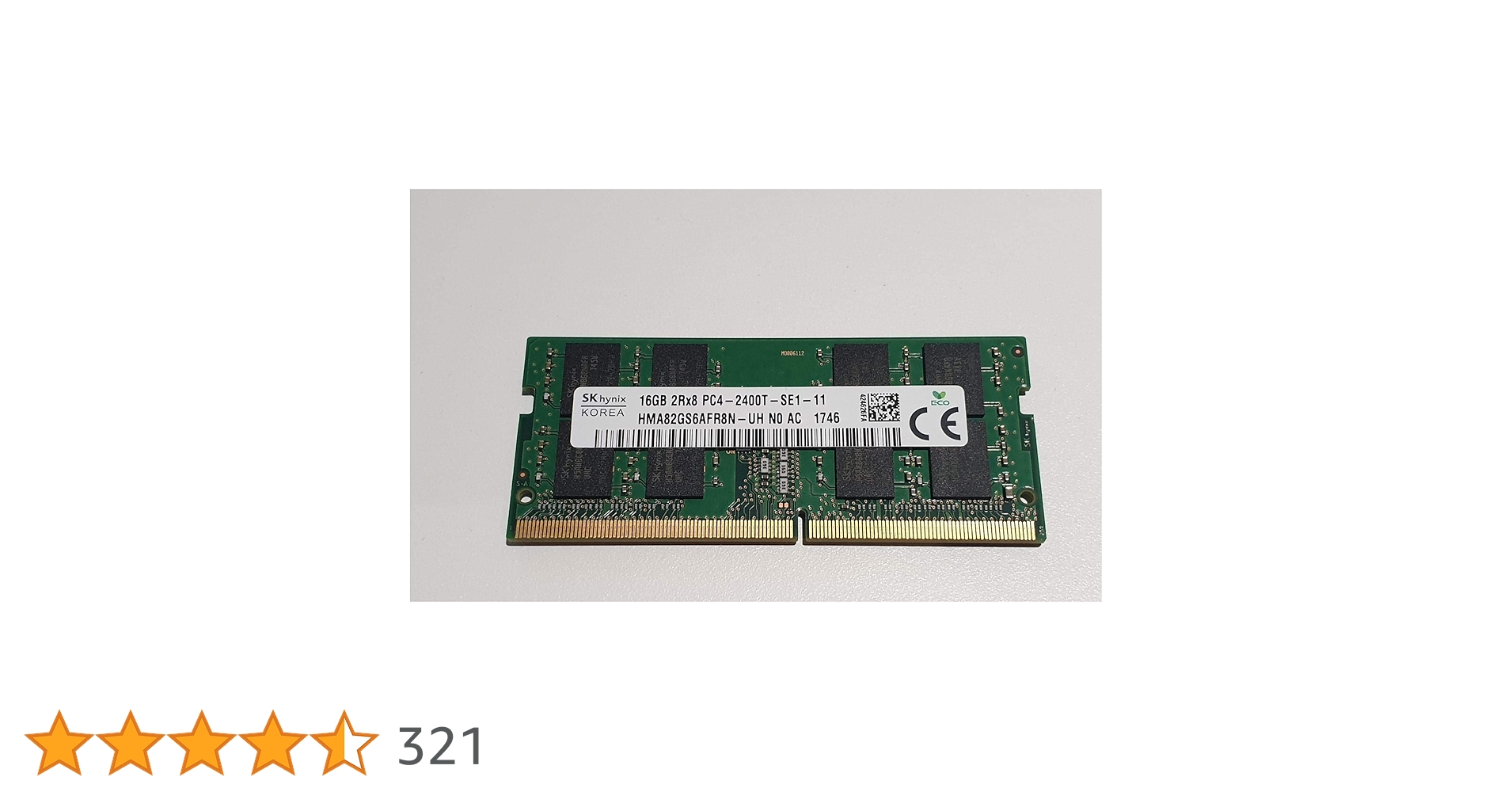

Below one is readily available at my location. Is this good?
02-02-2021 03:31 PM
OK good.
So the report shows you can install 32 GB.
I would get this one. It is 2666 MHz, but will automatically bridge to 2400 MHz and it is cheaper than the one you posted and I don't even know if the Hynix memory would work or not.
You can also get the Crucial 2400 MHz chip, but is is much more expensive than both of the others.
