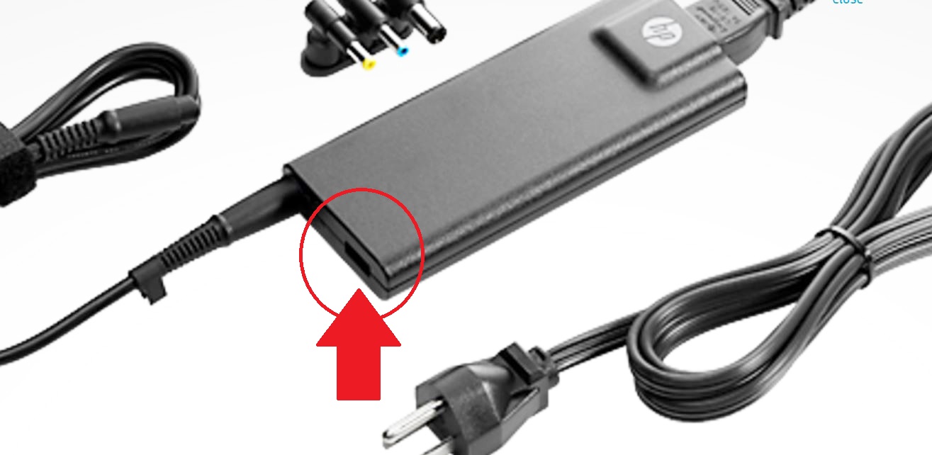

So per customer service..... The USB port on this universal is up to 90W..... which means we should be able to buy this and just get a regular USB to USB-C adapter cable.... I am going to try it....
http://store.hp.com/us/en/pdp/hp-90w-slim-ac-adapter
and
https://www.amazon.com/dp/B01C2MWDKS/ref=psdc_464394_t3_B01B634WNK
~Grofica
Thanks, good to know that a different 90w adapter might work.  Unfortunately, it looks like the one you referenced has only round/barrel connectors, so the Aukey adapter cable from Amazon won't work with it.  HP might have other 90w adapters that have USB-A connectors (that is, USB 3.0 connectors) that could be used with a USB-C adapter.
I have done some Googling on the USB 3.1 and Thunderbolt Power Delivery system (which both use the USB-C connector).  There is a complicated negotiation process between the power supply and the powered device to decide what power profile they will use.  The profile sets the voltage and amperage, and thus the wattage.  If the older 90w HP power supply doesn't support the USB 3.1 Power Delivery negotiation process, then it may not work with a USB-C adapter.  But any third party adapter with a USB-C connector will probably work.  Apple makes one; it is a little pricey but it may work.  Eventually, some third party like Belkin or Aukey will probably have on on the market, and probably for less than HP will charge.  Still, it is odd that HP can sell parts that require strong skills to replace, but can't sell a plug-in part.
It has a USB a port right on the front dude so yeah that cable will work
~Grofica
it has a USB-A port on it.... you wouldnt even have to use those other adapters or the two prong cord. plus customer service said it would work with a USB-A to USB-C cable.
~Grofica
