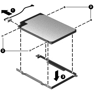

Here's a picture of the Hard Drive Hardware Kit for the HP Split x2 from Best Buy model 13-g110dx, spare part number
736884-001:
Notice the cable connector (1).  It does not appear to be a standard, full-size SATA connector.  I'll provide an update tomorrow.

Update on Split x2 from Best Buy model 13-g110dx HDD upgrade
I spoke with several folks from HP, both technical support and parts store personnel.  No one could definitively say what the actual manufacturer's model number was for the HDD, part number 737957-005.  However, the parts store rep told me the drive was made by Western Digital.
If this is the case, then the hard drive must be the WD Blue UltraSlim 500GB, model WD5000MPCK.  This is the only 5mm, 2.5" laptop HDD made by Western Digital.  This is unfortunate because it is the only 2.5" laptop HDD in the world that currently uses the small form factor SFF-8784 edge card connector.
I will try to contact someone at Western Digital to determine how this hard drive might be sourced.  The HP parts rep did not know if/when this HDD would be available to them.
As it stands now, the Split x2 from Best Buy model 13-g110dx effectively cannot have an internal hard drive added to it.
