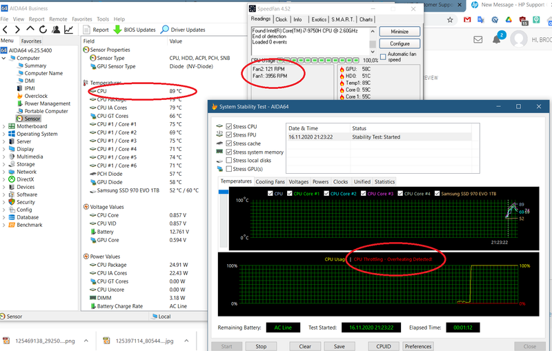

The fan starts spinning when the CPU reaches about 90 degrees
What I've already tried:
Change Windows.
The BIOS was F23, flashed over the same BIOS.
Resetting the BIOS settings.
It is not possible to flash the BIOS version F11. The firmware program refuses to flash.
The laptop is pretty hot. Inside clean, worked very little (about 100 hours)
Maybe there is a program that could programmatically turn on the fans? SpeedFan and NoteBook FanControl can't do this.
