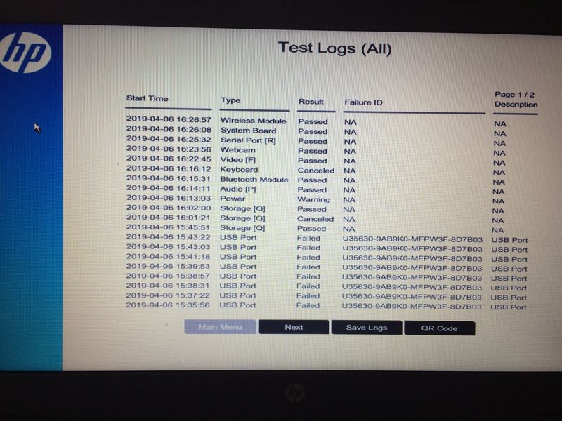

What needed to be done for replacement or repair? Please let me know what to do
After running PC Hardware Diagnostic Extensive Test I got UEFI test failure code
-QR code.
test logs list:
.Keyboard cancelled
.storage (Q)  cancelled .
.USB ports failed
.Everything else passed
You did not post the error Code but if you have bad USB ports that means the motherboard needs to be replaced. Are you under warranty?

Here is the Error code after running Extensive Hardware Test:
Qr codeQr code
Test logsTest logs
Please let me know after your seeing the Code and test logs  if there is anything else I need to know.
How to get the replacement of mother board for my Stream 14-cb012dx ? Who should I contact?
That's definitive proof of hardware failure which should be covered by warranty. This is a User to User Forum. You need to make a formal warranty claim.
