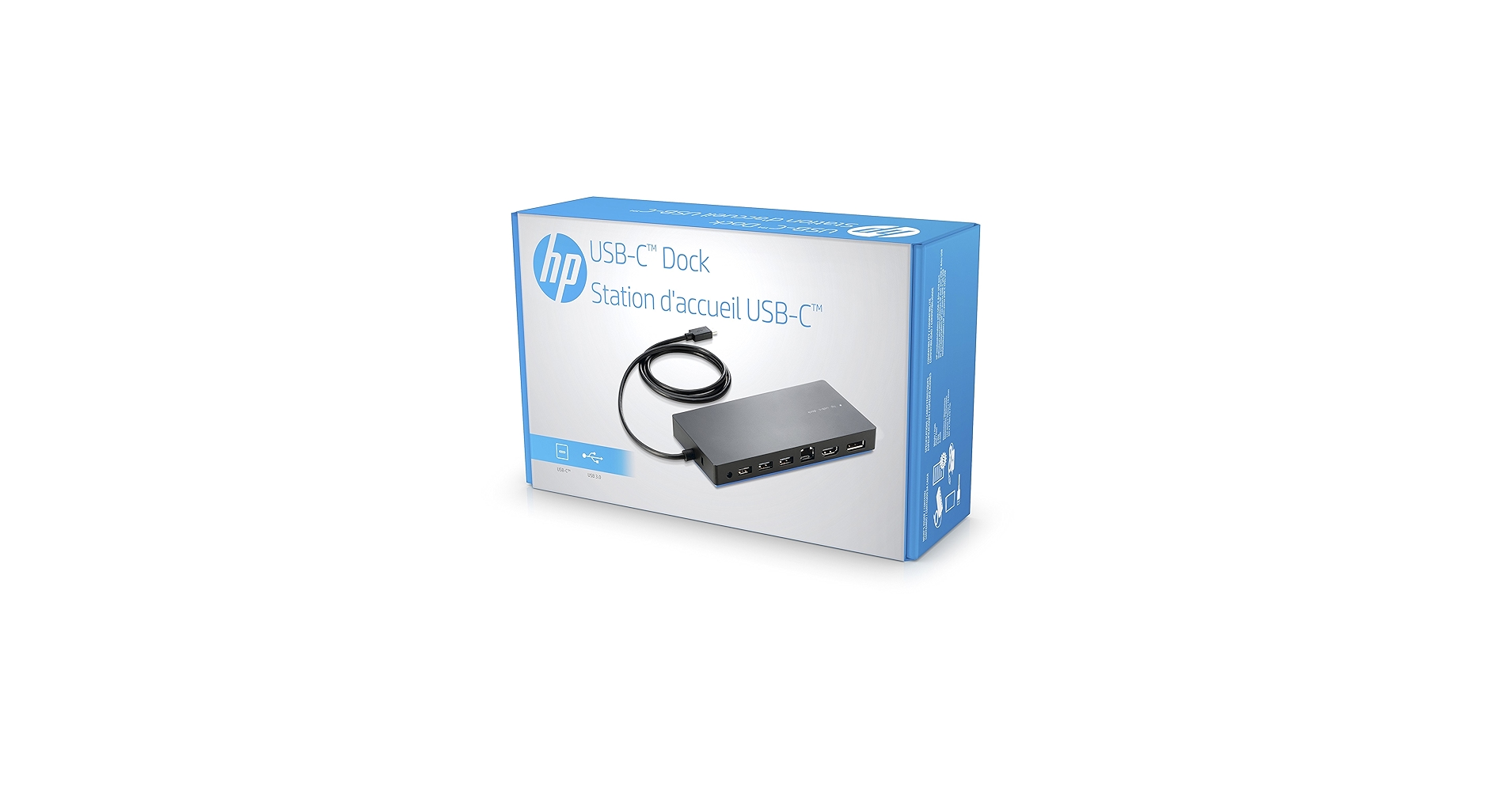

So I have this same model... And this HP Rep really Made this more complicated than it had to be...
Straight answer: USB-C port is basically useles sin this model unles syour planning on hooking up a cell phone for storage media via adapters.
It does not accept power or thunderbolt connections.
HOWEVER, the standard USB 3 connector DOES work with HP's USB C Docking station. The docking station comes with a USB C to USB 3 Adapter. Although you will need to plug your normal power cable in but at least its only that ONE USB and Power cable to your laptop. I can confirm it supports a external display using this method either via HDMI or DVI.
Here is a link to the one I got: https://www.amazon.com/HP-Laptops-DisplayPort-USB-C-Ethernet/dp/B01MTOCLUQ/ref=sr_1_3?ie=UTF8&qid=15...
I Really should have paid attention to the port saying Thunderbolt.
After a stressful week of research and testing I finally found an option that works, is more affordable, and can be picked up at your local Bestbuy.
Drum roll please! It’s is the J5Create (JUD380). Cost me about $75 at Best Buy. Once you buy it MAKE SURE you download and install the driver from their website. Just like that, you’re up and running with dual monitors! I believe the key is the driver. With that said, I think it’s possible that you can get a cheaper J5 Create adapter model along with their driver for it and get the same results. I haven’t tested any of the other ones with the driver but my local Best Buy does allow you to try before you buy, as long as the adapter you use is an “open box” item. If it isn’t “open box”, you have to buy it, try it(with the driver installed), and return it right then if it doesn’t work.
https://www.bestbuy.com/site/j5create-usb-3-0-mini-docking-station-silver/5901250.p?skuId=5901250
