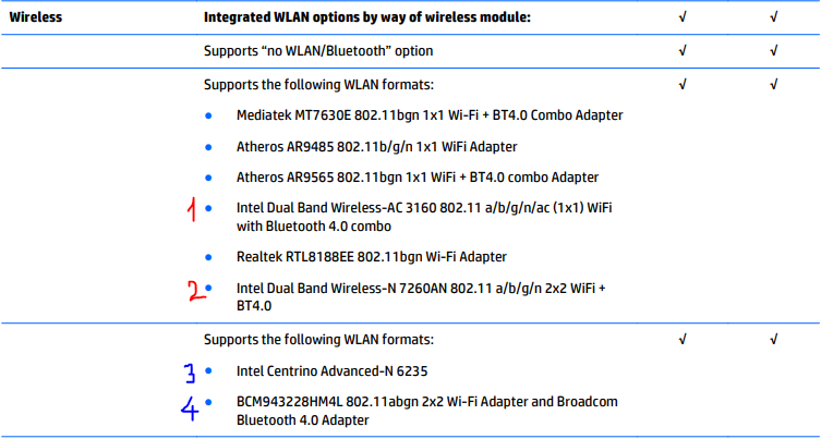

While reading my laptop's maintenance and service guide book (can be found here on page 3), I discovered which WLAN formats are supported by my model.
Picture 1: Screenshot from HP Probook 450 G1 Maintenance and  Service Guide, page 3Picture 1: Screenshot from HP Probook 450 G1 Maintenance and Service Guide, page 3
Out of all these cards, these four support 5GHz band, but I'm mostly considering 1 and 2, as they're the newest and seem to have most positive feedbacks.

Question: Is there any way I can confirm whether my laptop has "whitelist" problem before buying new card? I don't want to pay for card and insert it into my laptop just to find out that it can't work because of whitelist issue.
He also claims in the post below that the Intel Dual-Band Wireless-AC 7260 is the best card for my model of laptop, but what confuses me is that card is not listed in the guide as supported card (see Picture 1 above). The most similar one listed is Intel Dual-Band Wireless-N 7260, which is also 7260, but the difference is it supports newer AC standard.

Is the list of WLAN cards from my laptop's service guide (Picture 1 in main post) basically the "whitelist"? Meaning if, by some reason, my laptop has a "whitelist" problem, does that mean that:
a) I can only replace my NIC with the exact same card I currently have, or
b) I can replace my NIC with some of the cards listed in the guide as compatible (Picture 1 in main post).
Which one is correct, a or b?
You're very welcome.
If your notebook has a BIOS whitelist, then you can only replace the wifi card with ones listed in the service manual, and not only that, it MUST have the HP part number on it or it will not work.

Thank you very much, that was my other concern: Whether it's enough for card to just be the same model as listed in service guide, or it also needs to have the same part number and be from some official manufacturer. Because as far as I can tell, fenvi is 3rd party manufacturer and the cards it produces/sells are the same ones listed in my laptop's service guide, but because their cards probably don't have the exact same part number, they wouldn't work on my device?
