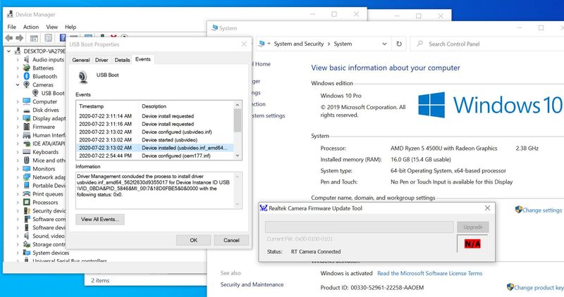

 The Device ID I have is : VID_0BDA&PID_5846
In your post, this doesn't work :
in order to do it download on your PC disk this PDF file and follow the instructions:
https://support.hp.com/wps/hp-skp-portlets/document/manuals/inline/c06644493.pdf
In SuseB post :
this firmware update.
https://mega.nz/file/TAQBUKzJ#uehqR1xZYnEca3k8ZnID8CtpLeSKUSgI8IUv_BWqGY4
I tried it and it comes with this error : N/A
Do you have other recommendations ?
The PC has been already reimaged by HP by the way.
Bye and hope to read from you soon. Thx

With the above tool from realtek i was able to update the webcam firmware. Now is working! Problem solved.
