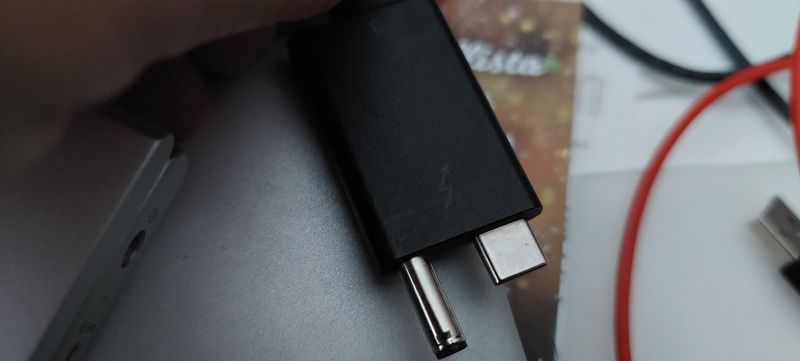

I have a Thunderbolt Dock (older model) that I cannot hook up to my new HP probook because the cable that is to be attached to the computer has too narrow a space between the flat and the round bits. Is there an adaptor available, or do I have to buy a new dock, which sounds crazy.... 20230525_195208.jpg20230525_195238.jpg

That shouldn't be a problem because the current HP laptop I have from work doesn't have a thunderbolt picture either, yet the dock works well. The HP dock is the model Thunderbolt Dock 230W G2 . The old computer is a HP Elitebook, and the new one HP Probook 445 G9.
The old computer is a HP Elitebook 756 G6, but neither the old nor the new has the lightning symbol at the c-port, they have exactly the same symbols at both ports. The distance between the ports is just about 3 mm too wide on the Probook...
Doe the parts of the Combo cable separate or is it a solid unit?
Does the Combo cable unplug from the bottom of the dock?
Unfortunately it is a solid piece and it is not possible to unplug the cable from the dock. Perhaps I could try to plug in a port-c cable into the dock and then to the computer (there is a cable-c port in the dock, but it seems to be only for charging, has the lightning symbol on it) . I tried to do so with the cable from my phone charger, but it didn't work, but perhaps it needs to be another kind of c-cable, a data cable, I have to check and see if I can find one so I can try. And then use the computer's own charger to keep the computer charged. the current combo cable both charges the computer and forms the connection to the dock.
