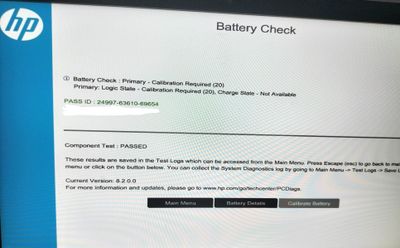

my laptop charges till a fixed point like now it is 89% and doesnt increase even if adapter is plugged in . When plugged off it decreases by two or five percent and the system immediately shuts down . this is happening from quite some time and if i will keep it plugged in then the battery will swell and the warranty will void. I don't know what i am supposed to do. i tried downloading this software for the battery issue "sp165842" when i try to install it hgets downloaded and then it shows the file extractin failed . and i can't do anything else.

Hi @Devendra007,
Thank you for your response.
Kindly perform the Battery test and share the test result with us:
To perform a UEFI battery test on your HP laptop, shut it down, power it on and repeatedly press Esc, then select F2 (System Diagnostics) to enter the HP PC Hardware Diagnostics UEFI menu, navigate to Component Tests > Power > Battery, and run the test to check its health and status

this has come up and i also did that battery calibration it took 2.5 hours. No resolve yet.
