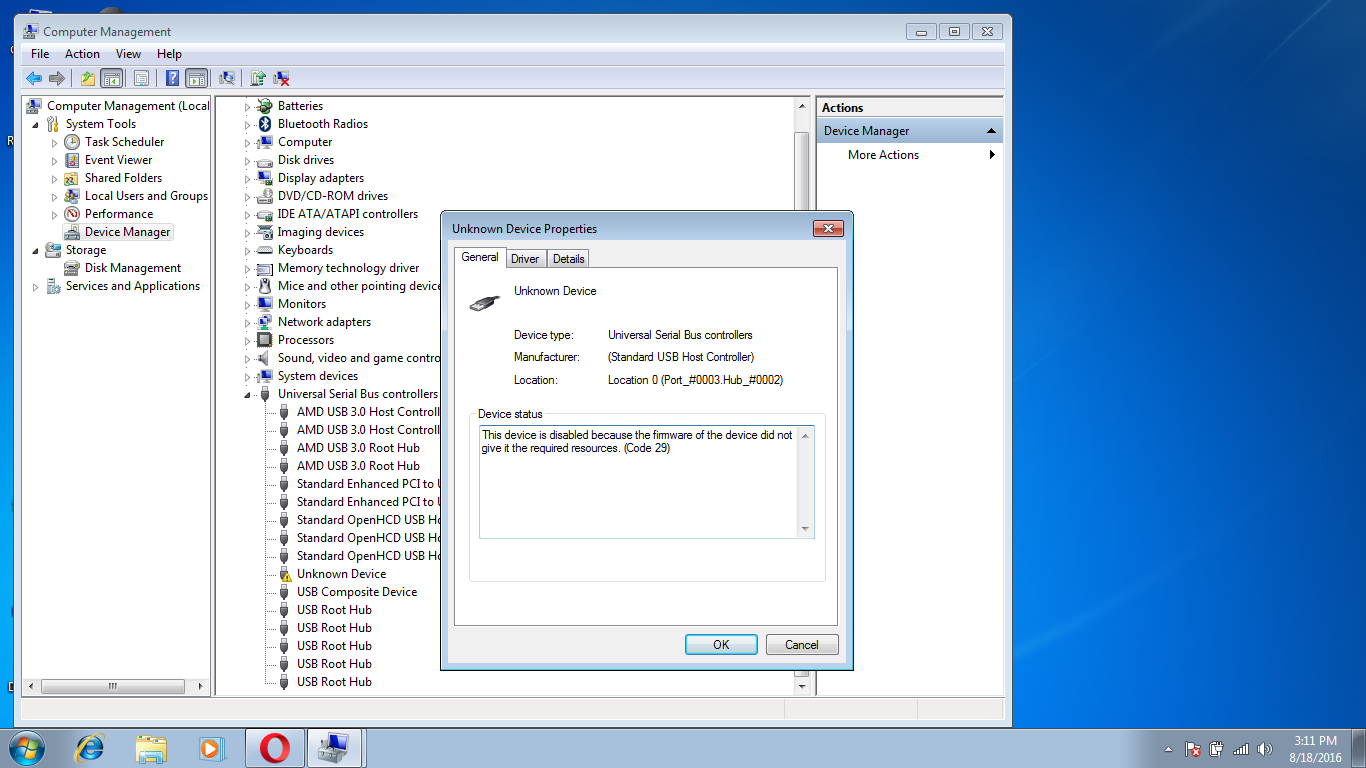

now am facing an unknown device problem  , my pc detects my 2 gamepads (joysticks) but says device not recogonised  error code 29  ...  but other usb input devices working well  like usb keyboard ,mouse, ppendrives. i used to play with these  gamepads without any probelm !   i tried everything uninstalled and reinstalled usb controllers , tried system restore and now i just did a clean install of windows 7  and downloaded all the drivers from hp ..  but the problem still exists !!   hp wnt provide advanced option on bios  right ? so how can i findout my usb support is enabled or not !!!      pls help me

now am facing an unknown device problem  , my pc detects my 2 gamepads (joysticks) but says device not recogonised  error code 29  ...  but other usb input devices working well  like usb keyboard ,mouse, ppendrives. i used to play with these  gamepads without any probelm !   i tried everything uninstalled and reinstalled usb controllers , tried system restore and now i just did a clean install of windows 7  and downloaded all the drivers from hp ..  but the problem still exists !!   hp wnt provide advanced option on bios  right ? so how can i findout my usb support is enabled or not !!!      pls help meUntitled1.jpgUntitled2.png

The Error Code 29 means that the device is disabled because the firmware of the device did not give it the required resources. The recommended solution for an issue such as this seems to be to enable the device in the BIOS.
Source: Error codes in Device Manager in Windows
Here is the Maintenance and Service Guide for you to look over. There are steps to access the BIOS in the document so that you can take a look in the BIOS and see if you can find the option to enable the devices.
