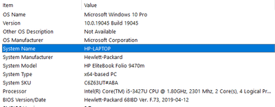

Hello @UncleScotty
Sorry to hear that you are having problems ... I would like to help you.
Let me check your basic system configuration before we take care about the <battery> problem ...
(1) Run    msinfo32
- Select <System Summary>:
--->>> Copy/screenshot/paste following key/value pairs:
OS Name
Version
System Model
System SKU
( equals HP product number (p/n) )
Processor
BIOS Version/Date
(2Please report back
Thanks for your help.
Here's the info requested:
