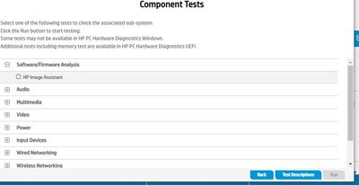

My System Tests seem to have been successful......
But  the run button on my Component Test screen is grayed out...as you can see in the bottom right corner.
Is there some way to "allow" these tests to run?
Are there any other tests I should be performing?
I'm using v. 1.8.3.0   Is that OK?
Hello @UncleScotty
v. 1.8.3.0 is ok.
Expand the Component tests and check [x] each test, then click run button.
