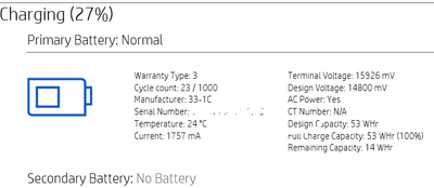

I don't know exactly which update(s) or procedure(s) did the trick, but when I plugged in my totally discharged computer this morning, it immediately showed that it was charging. THANK YOU!!
Here's the HP Support Assistant information you asked for.
Thanks again for your patience and all your responses.
Is there somewhere I can give you "kudos"?
