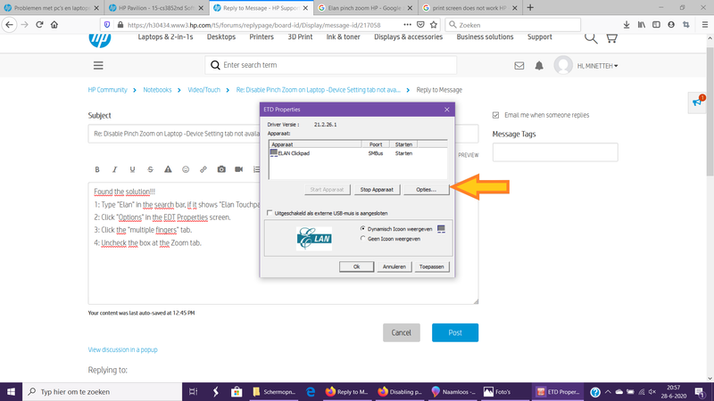

Found the solution!!!
1: Type "Elan" in the search bar, if it shows "Elan Touchpad Setting" click on "open".
2: Click "Options" in the EDT Properties screen.
3: Click the "multiple fingers" tab.
4: Uncheck the box at the Zoom tab.

Have you solved the problem I purchased a new computer a few days ago and had the same pinch-zoom problem with no way to disable? It is now sorted and it was so easy Type ELAN TOUCHPAD SETTINGS in the bottom right search box go to OPTIONS then MULTI FINGER then TAKE OUT THE TICK IN ENABLE click apply and ok and its disabled.
